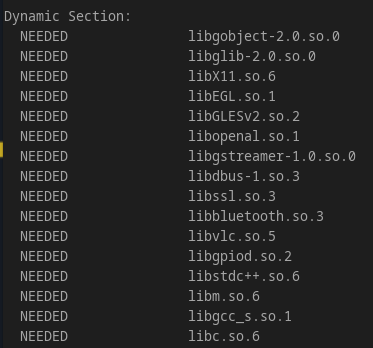

what RD version U use ? The latest uses libssl.so.3 (at least the PC v
ersion)
you can chek what libs required with the objdump -p /path/to/realdash command.
