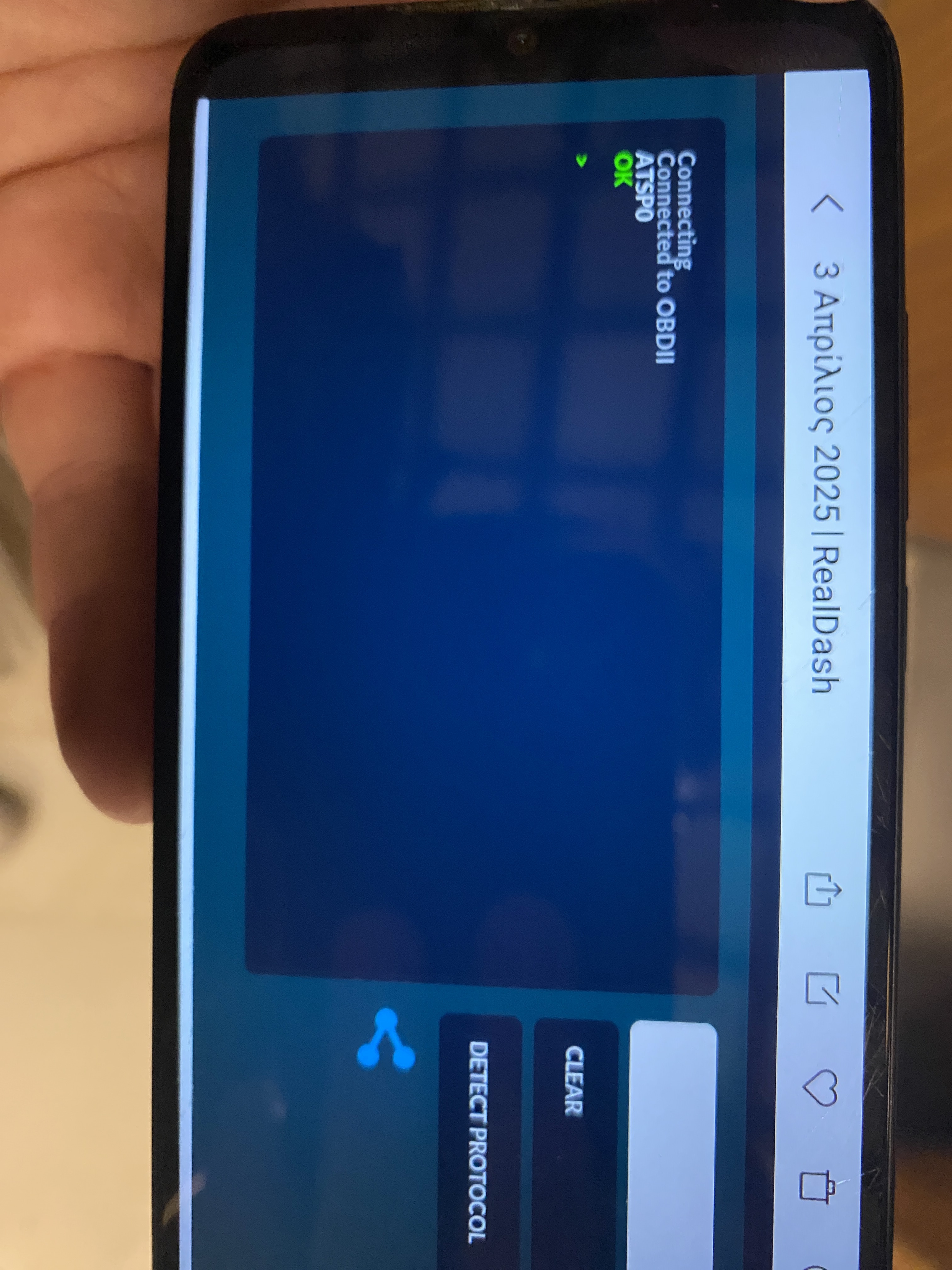

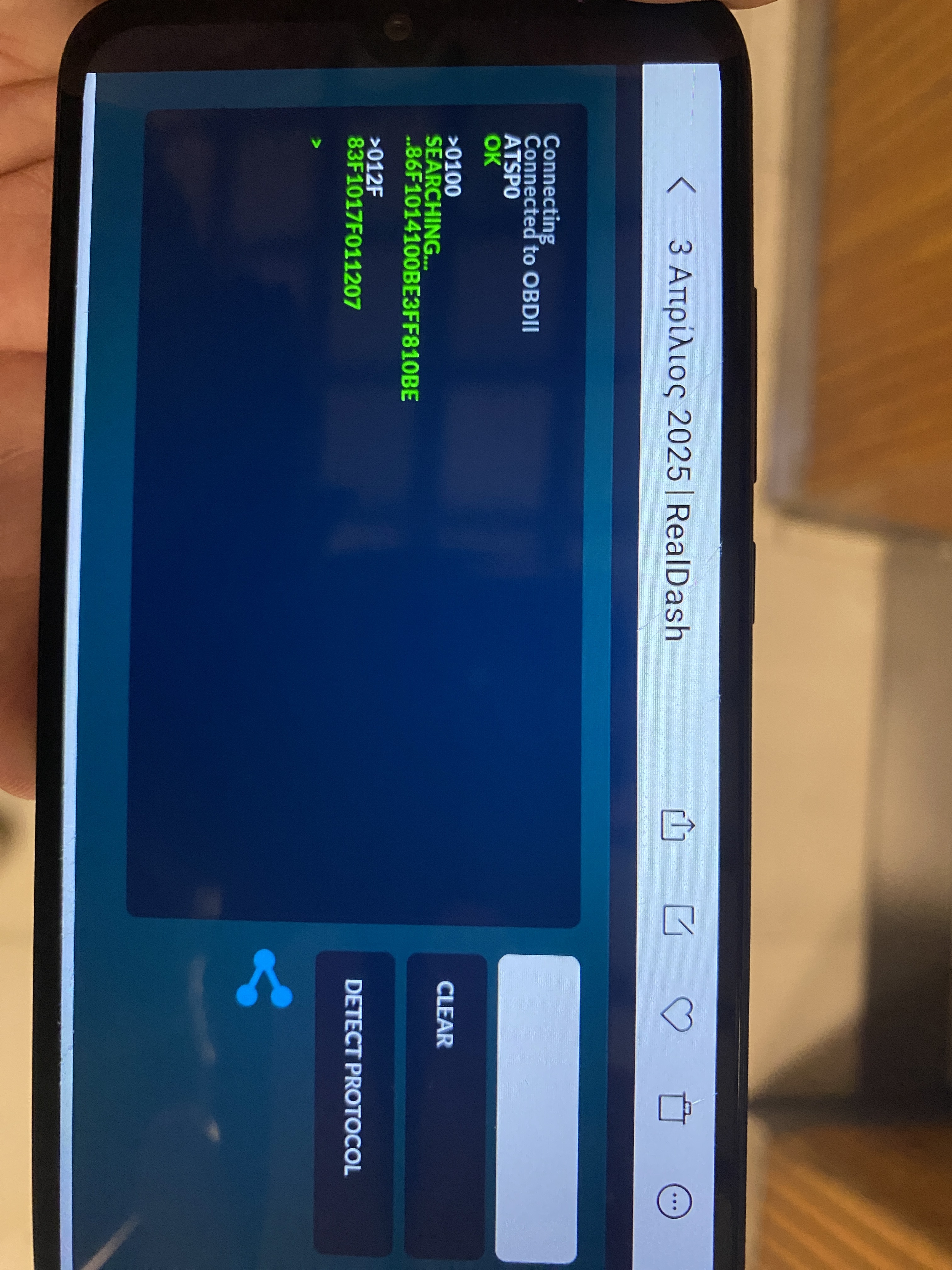

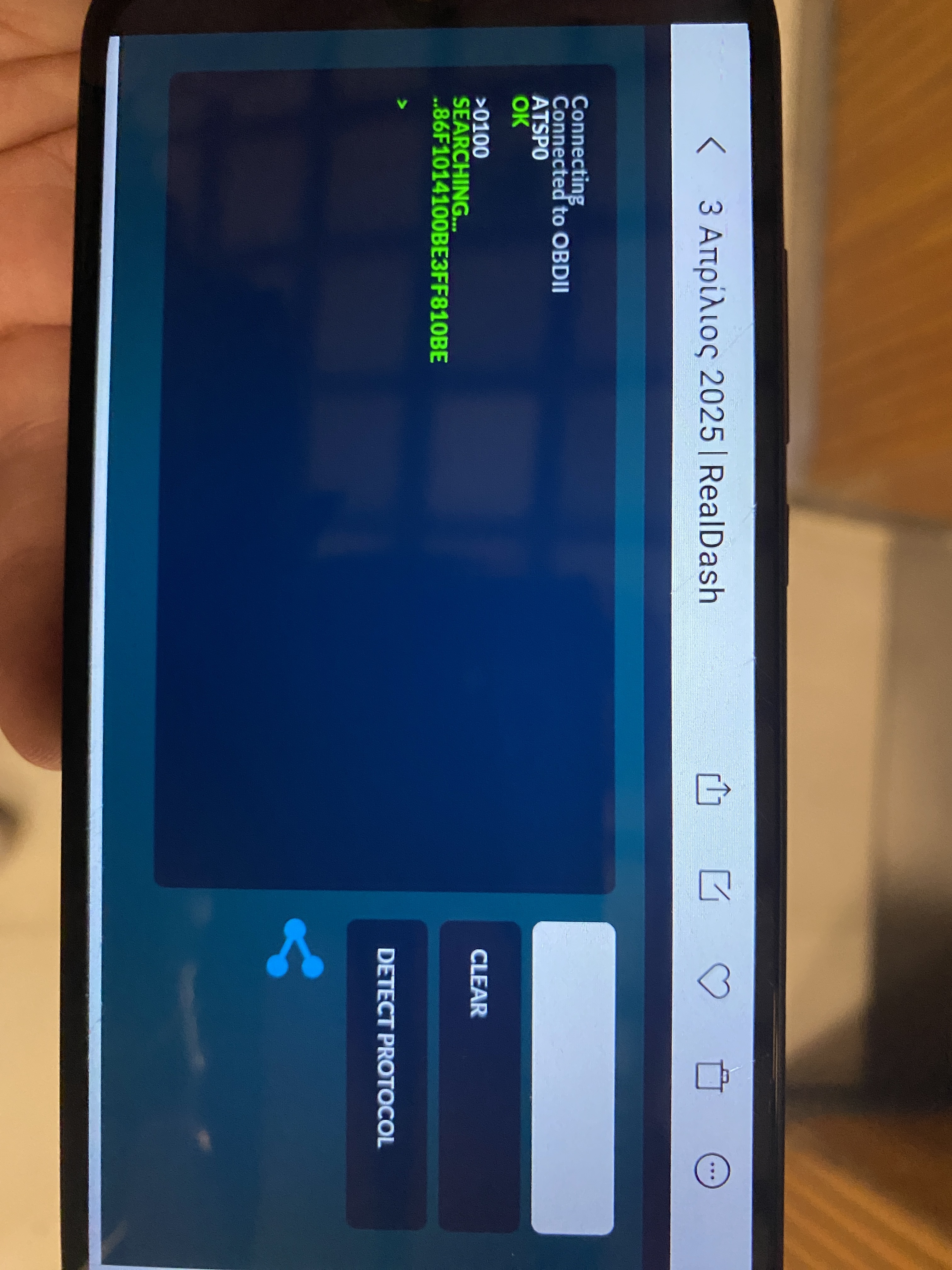

Also I check obd2 like y wrote
  1. Type commands
    ATSP0
    0100
    012F
Down is the results
