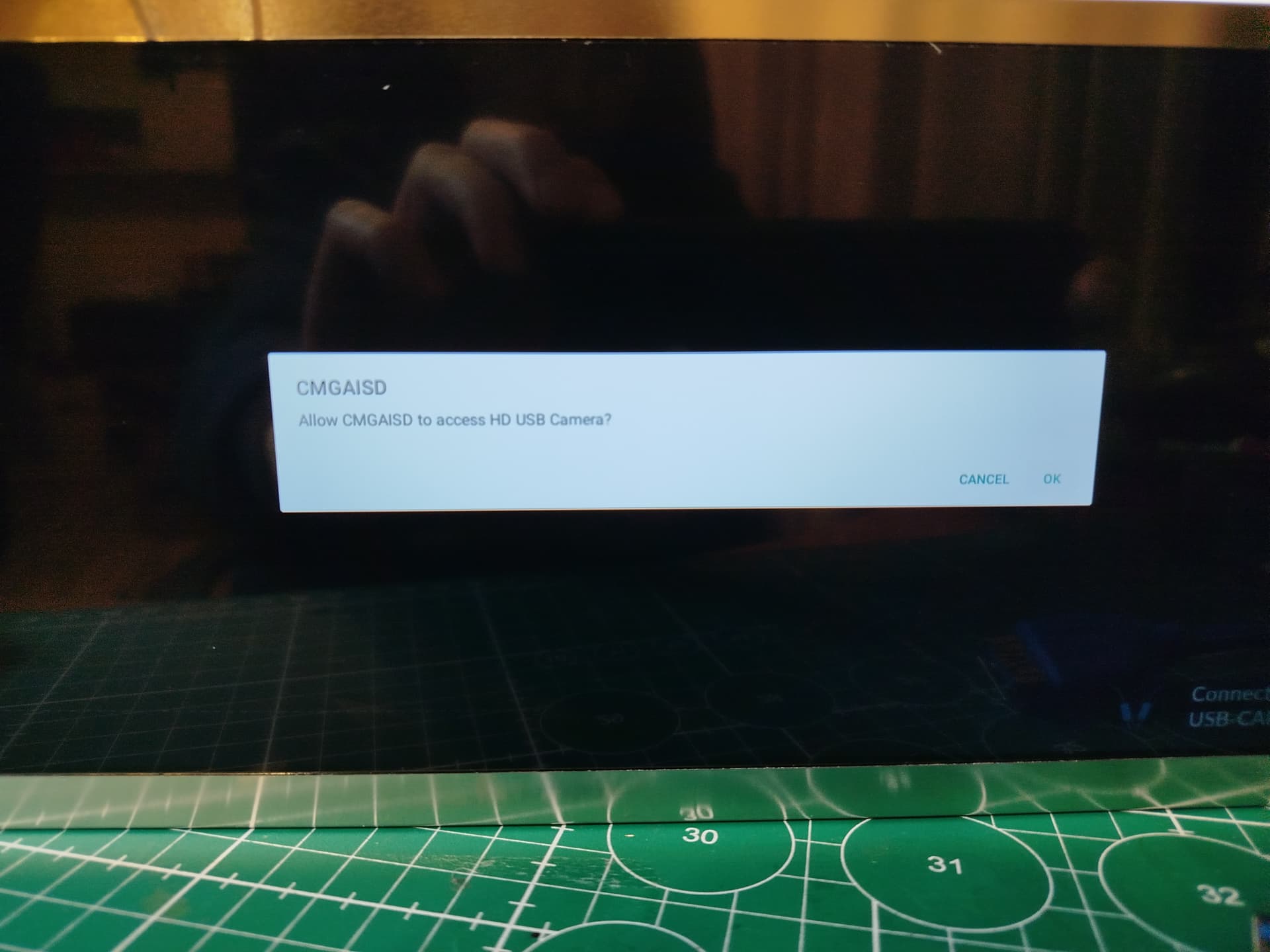

thank you for fixing the problem with the USB adapter when starting the android system, I will also forgive you to pay attention to the problem with USB cameras, which pops up every time you start. (I found the UIS 7262 firmware where the cameras started working)
You know that already that it is not possible for me to bypass Android security popups. Only way to achieve this is to build a custom hardware that always permits the USB connection without UI interference.
