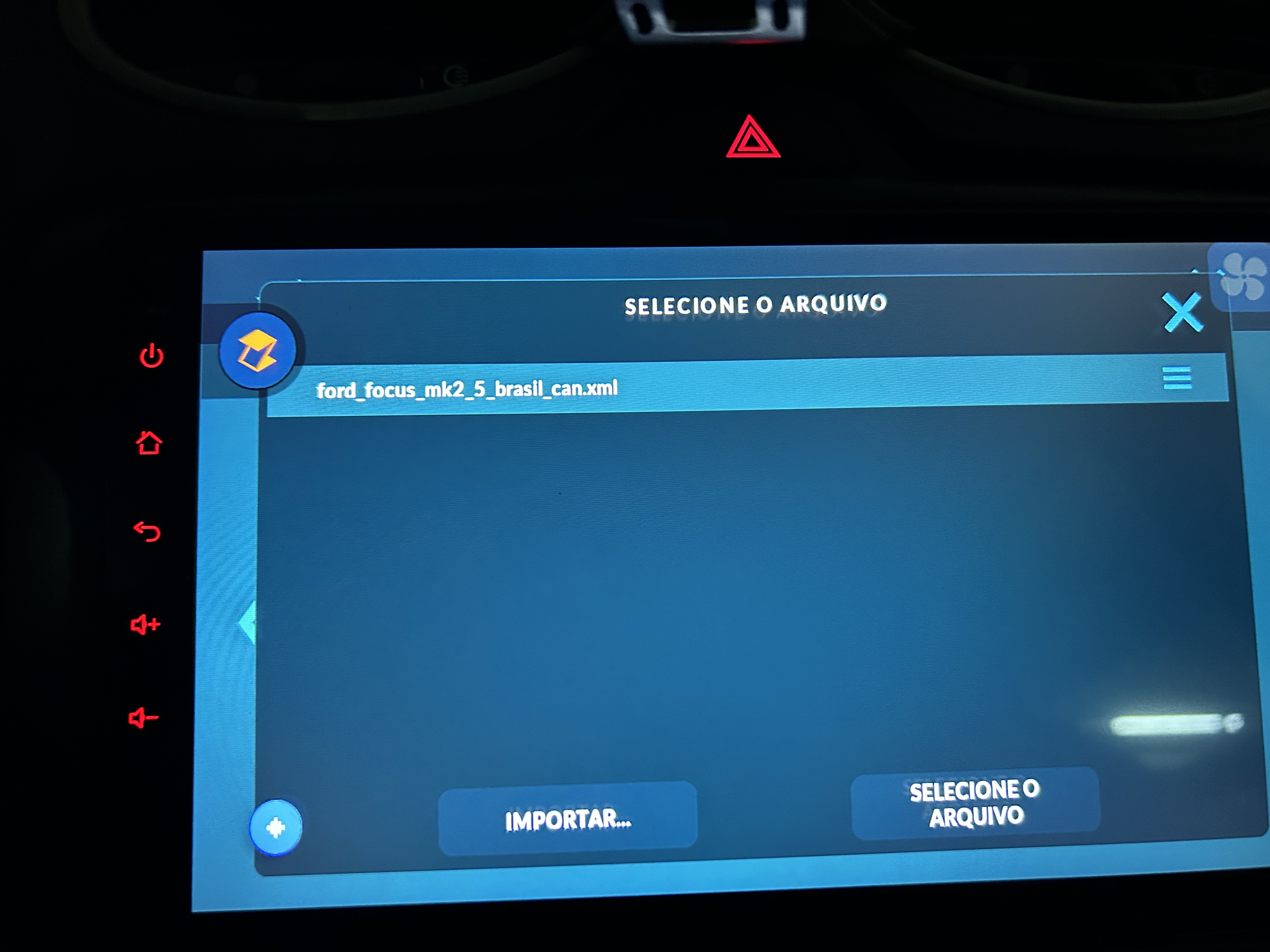

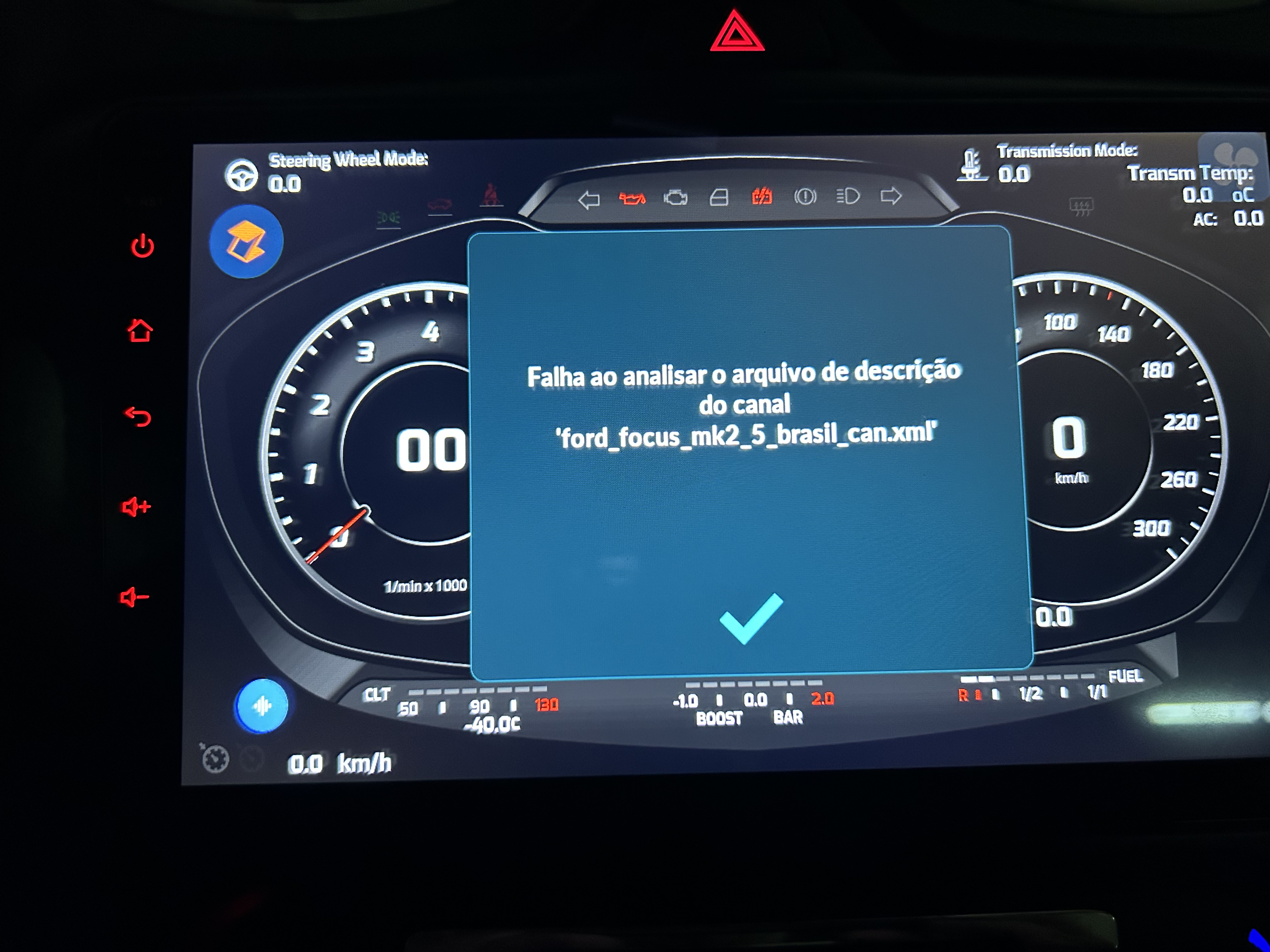

I have the same problem with XML files are not located after first startup.
How can I back to install the previous version of Realdash (before than v2.5.6) in my Android device? Because the last version have a issues with locate XML files during startup

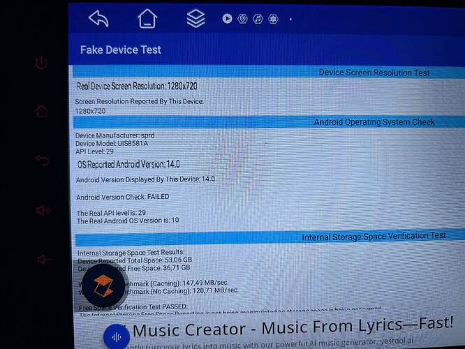

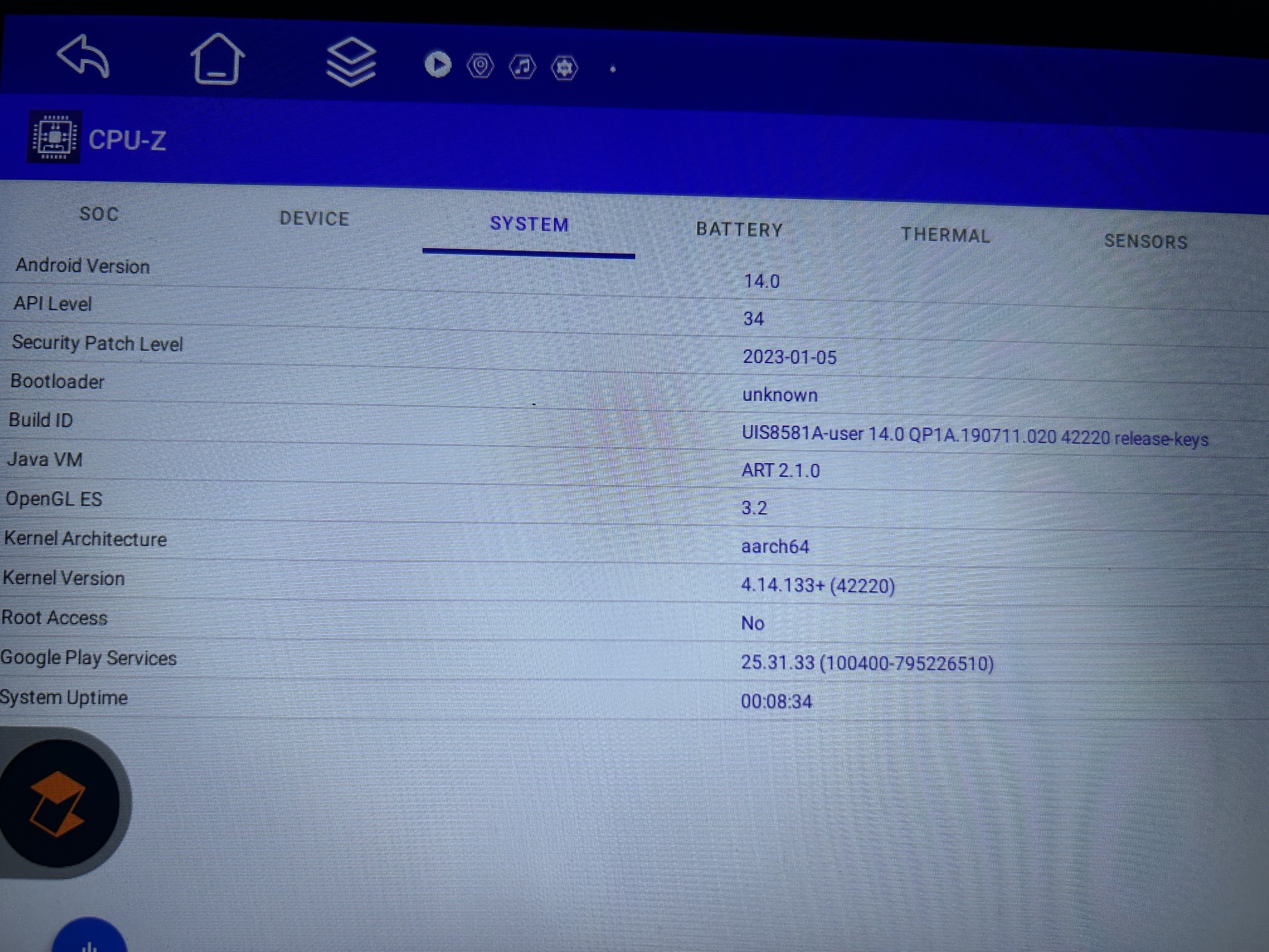

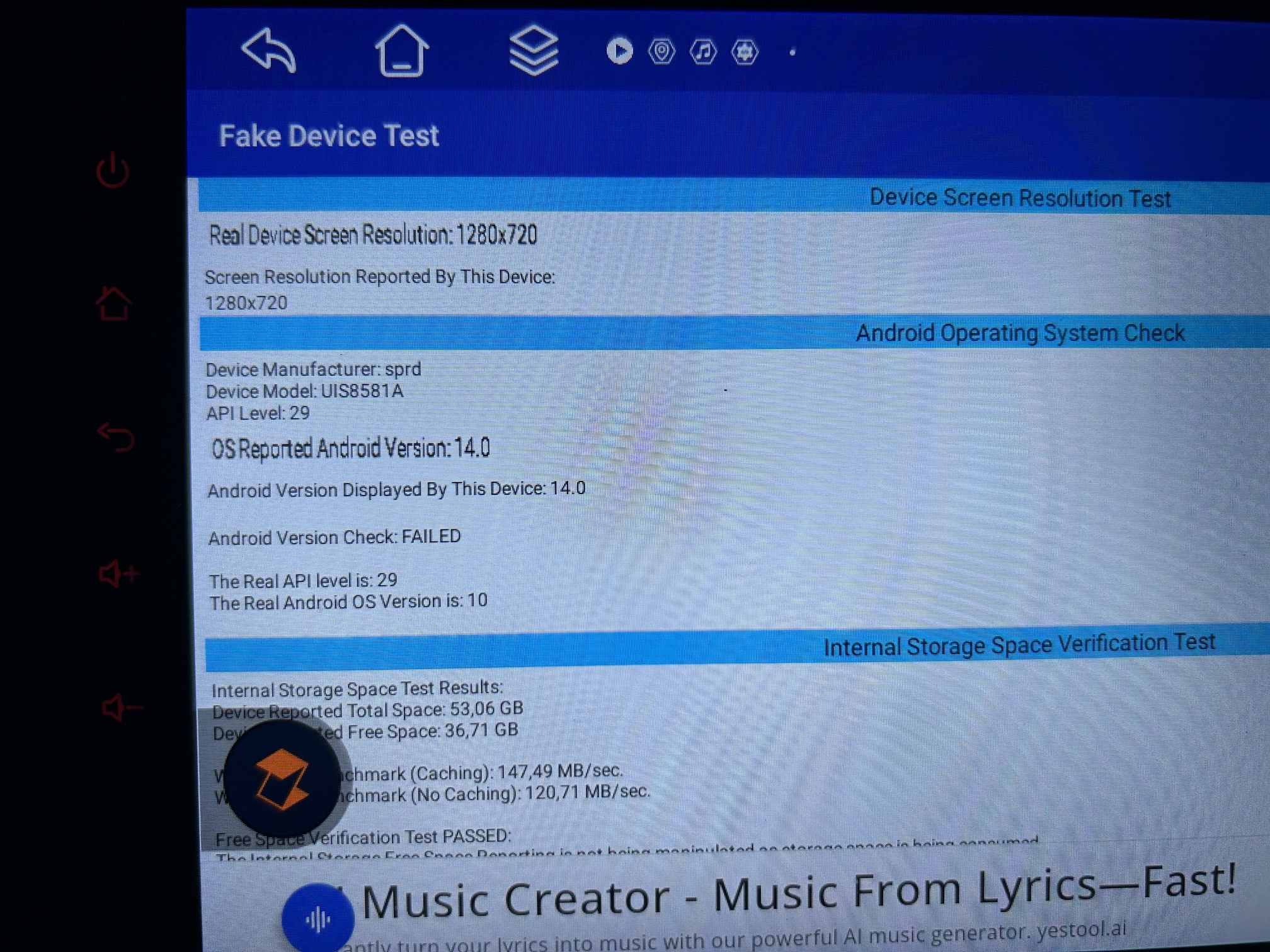

What name your device? and version android?
Android Head Unit (Car Audio Multimedia)
Android 10

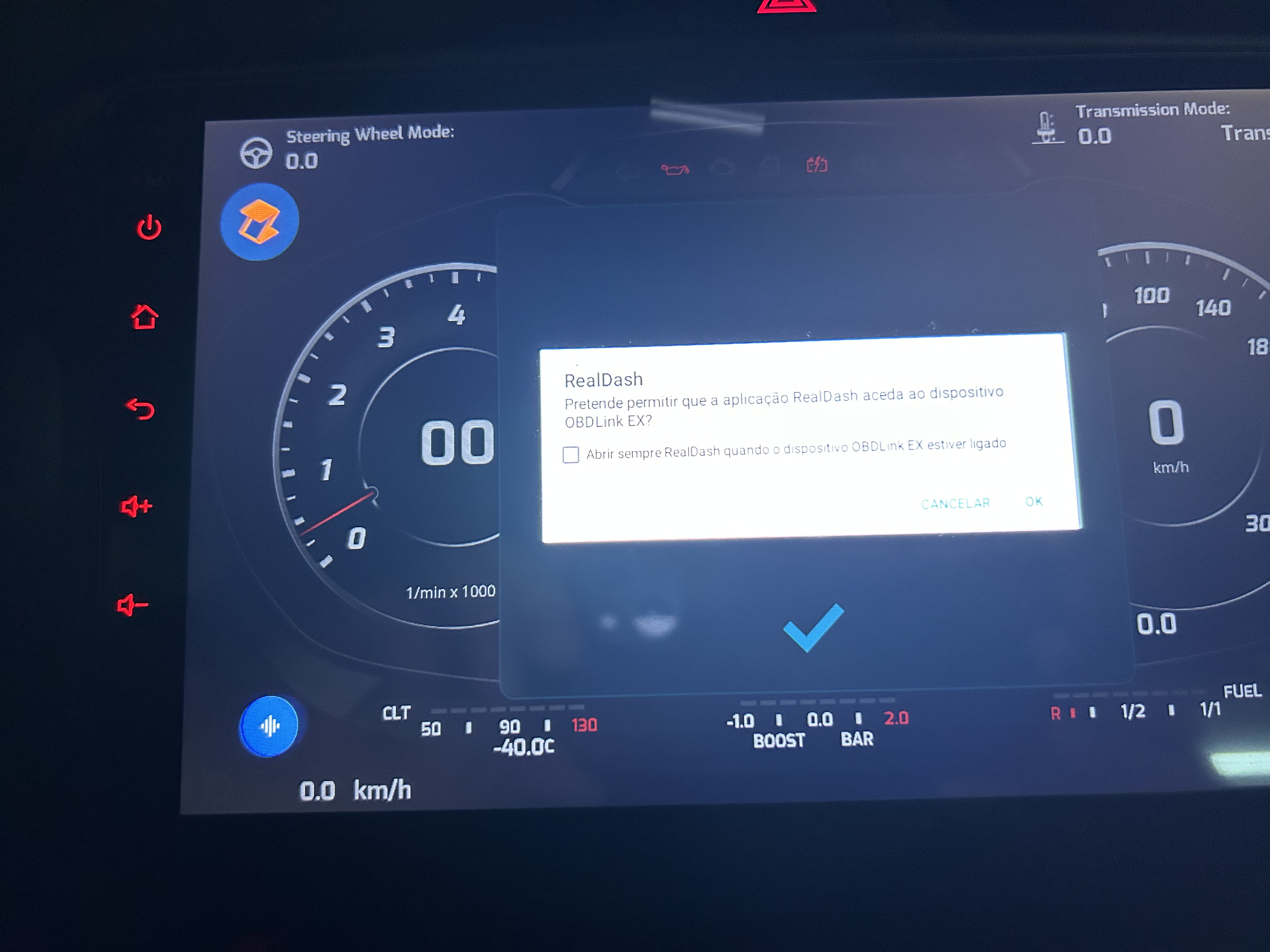

Also, I need check and confirm the USB usage permissions every
In this case, you need to talk to the firmware manufacturer, try it. In my case, the Chinese manufacturer solved the problem.
