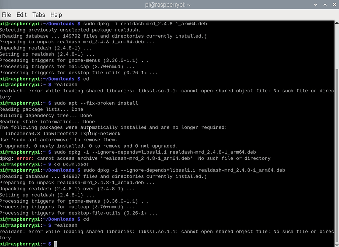

I’ve followed all of the instructions on how and what to specifically install, real dash is in the graphics folder as it should be. I click the program and nothing happens, is anyone else having this issue? Any idea what I may be doing wrong?
What happens if you open the terminal and type:
realdash
Nothing, no change in cpu load no errors or anything of the sort
You do not get any messages to the terminal when attempting to launch from there?
Absolutely nothing sadly, I must have messed something up on the install
Alright, installation must be broken somehow.
I’ll try it again on Dietpi, was having no luck at all after 3 reflashes of Raspbian 64bit
Yeah still no luck sadly
Could you try to uninstall/install and share the terminal output after install command is issued?
Will do, I’ll flash a new image of rasp64 and go from there
I got it, God I am stupid.
Thanks for the help! (I saw your fixes throughout the fourm)
