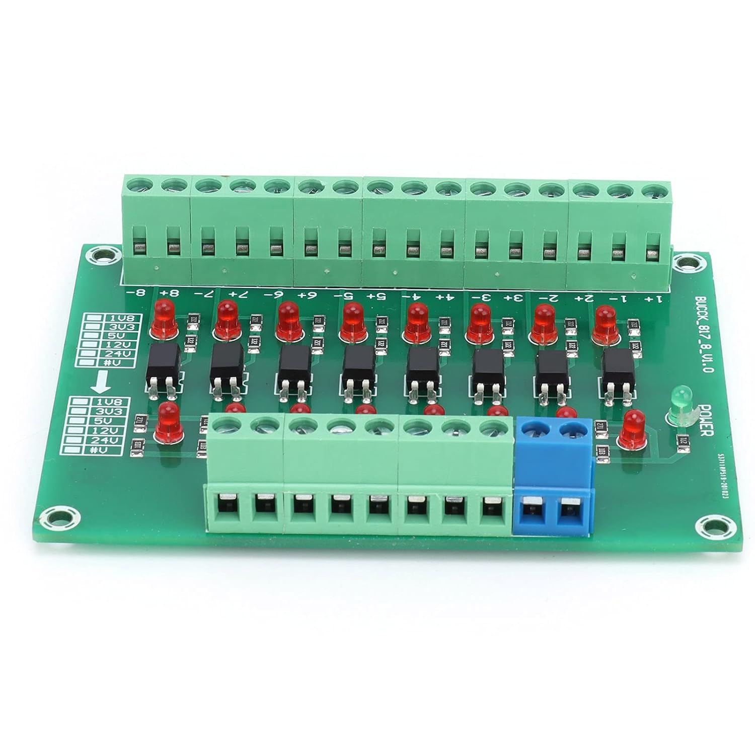

Okay, so I see it mentions like fuel level in the write up, what about turn signals, how would that work since it would be 12v from the stock wiring going to realdash
I am using an optocoupler that connects to the RPI GPIO.
