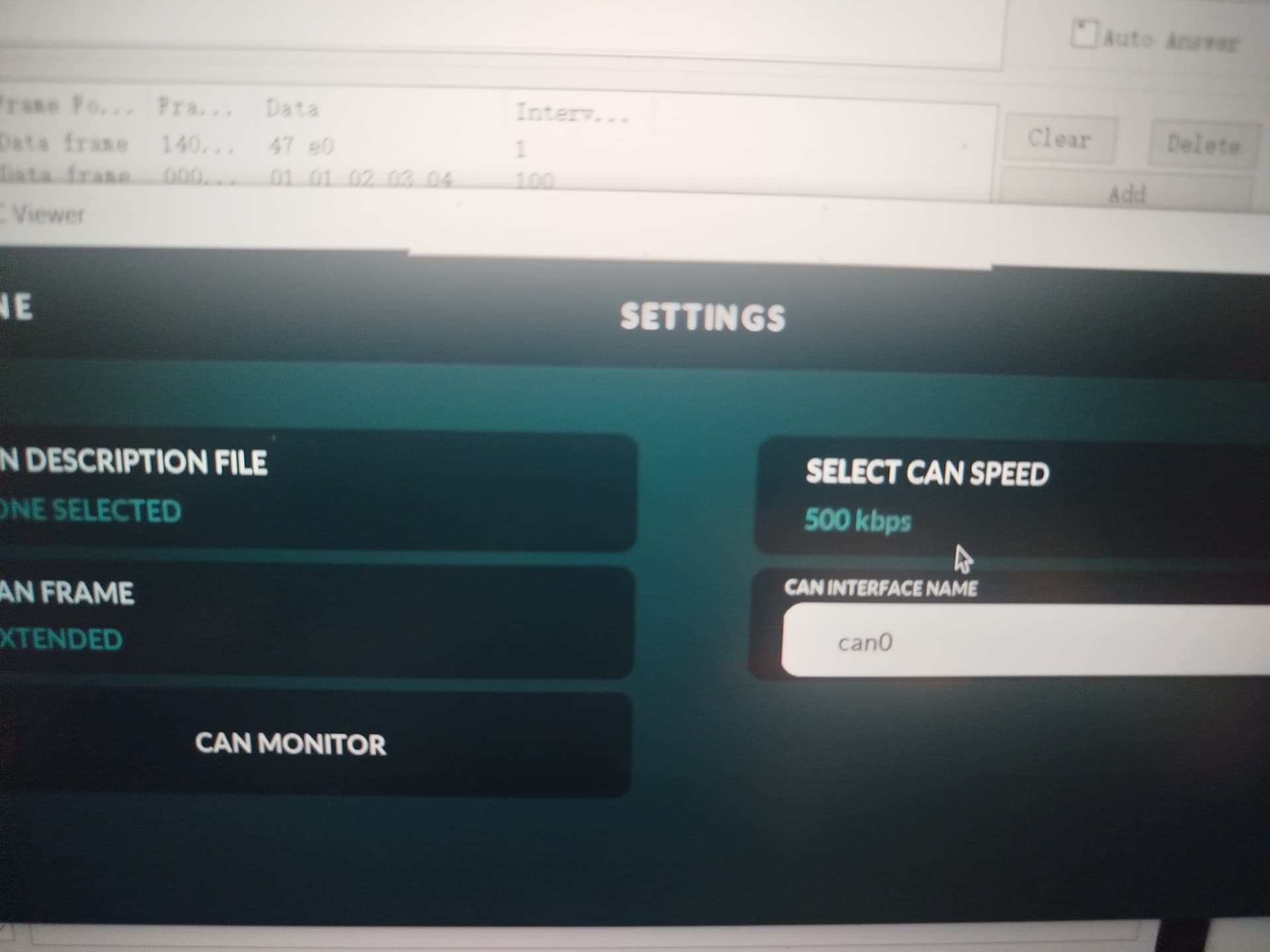

I can read data via CAN socket using a Raspberry Pi, but the CAN speed setting on the RD doesn’t work.

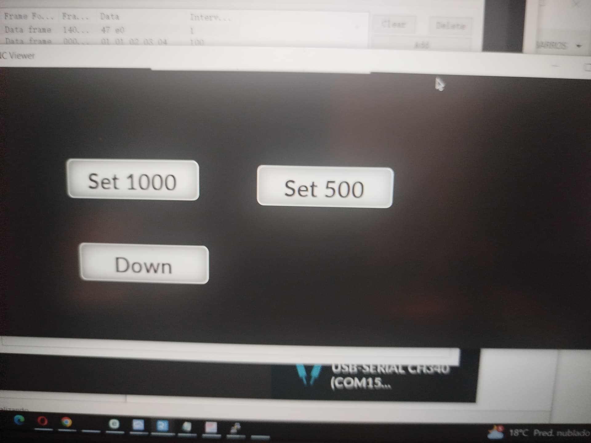

I f I made these buttons to change the CAN Speed, it works after pressing the Set button then the Down button:

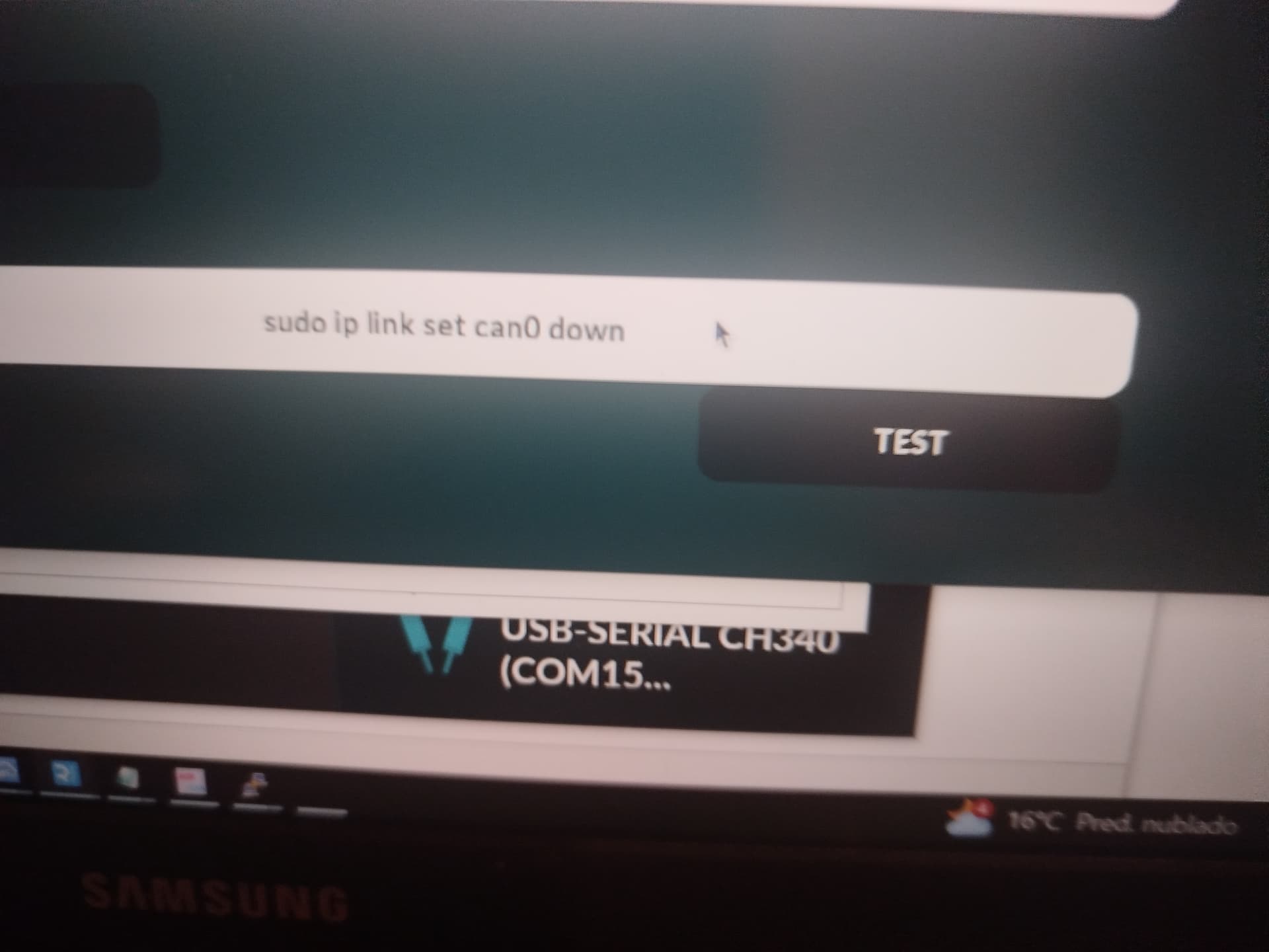

Sending via action vi Run Terminal command:
sudo ip link set can0 down

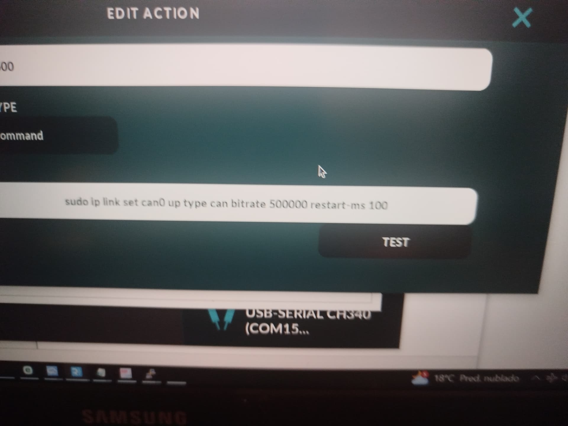

Then to change the CAN speed:

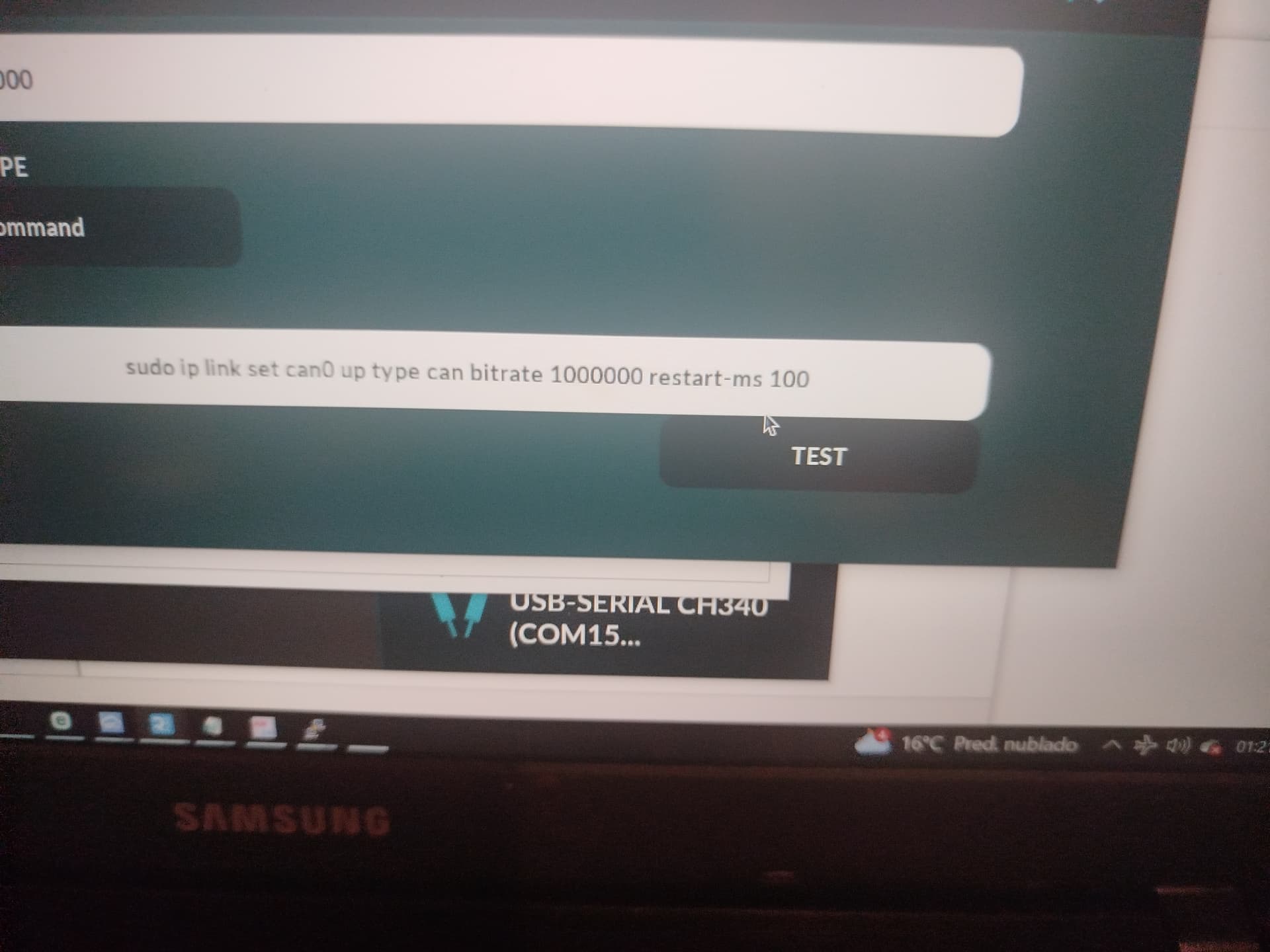

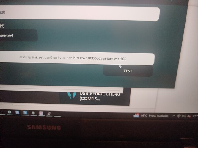

sudo ip link set can0 up type can bitrate 500000 restart-ms 100
This already works.
