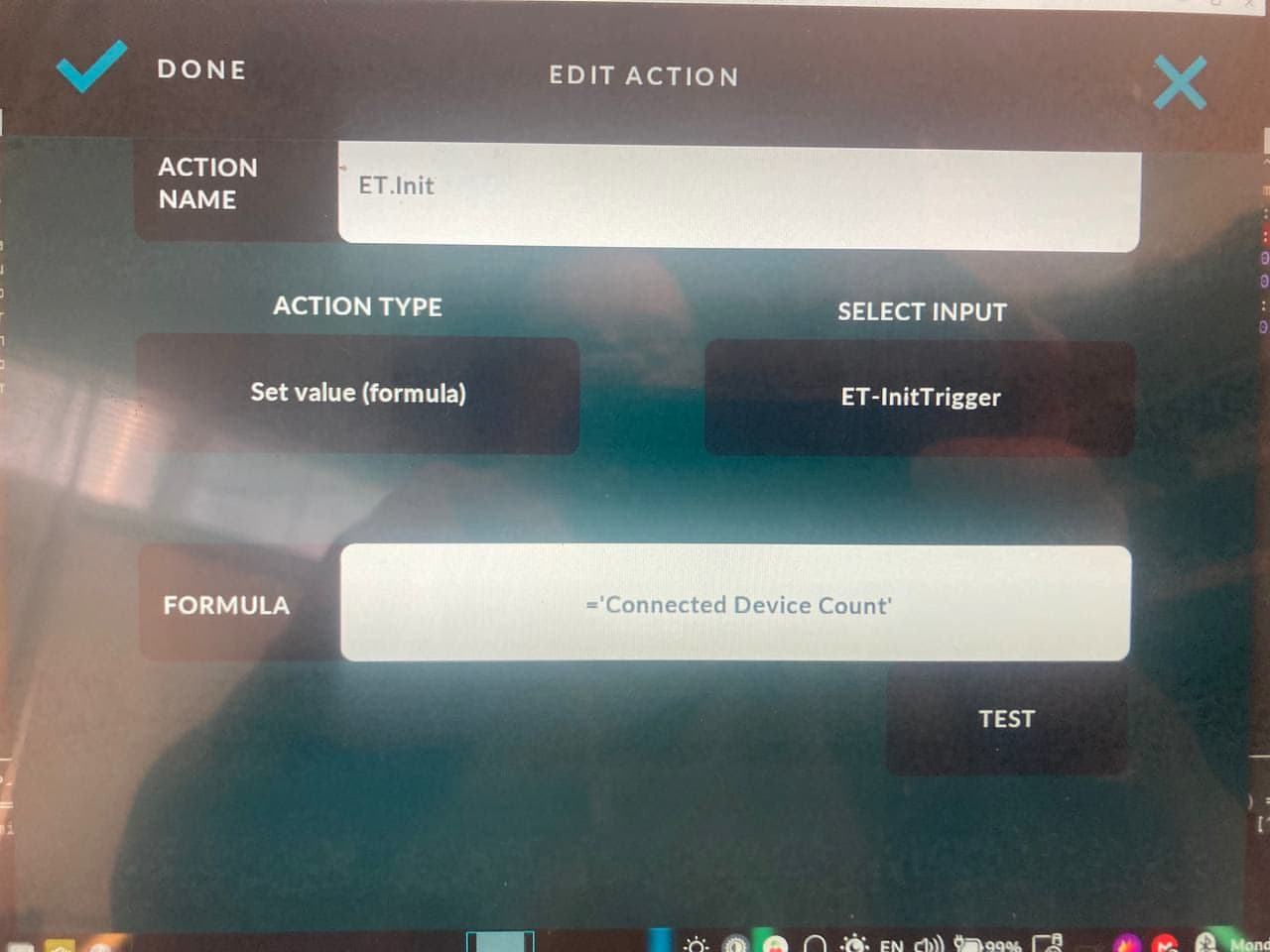

When I use in the global trigger “set value(formula)” and the formula set to ‘Connected Device Count’ the “test button” shows the correct count BUT after exiting from the app the app never starts again both on iOS and android.

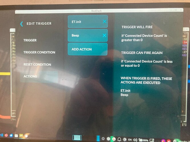

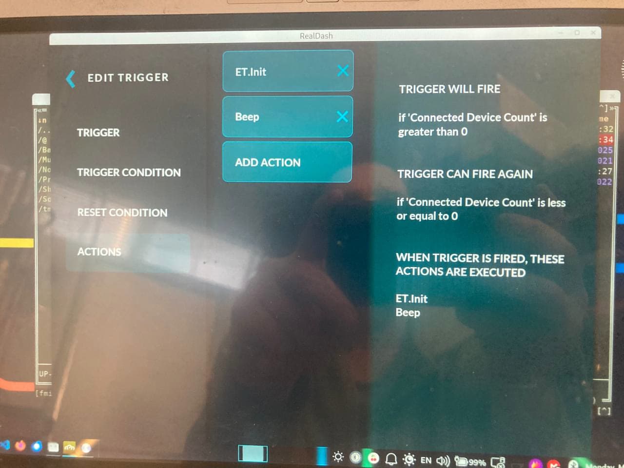

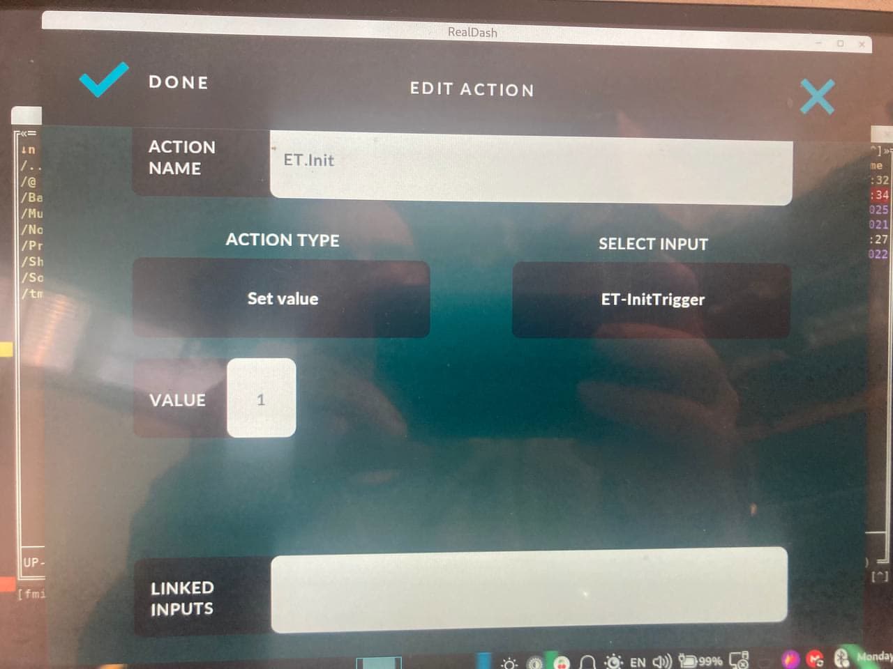

The second 2 pic the “trigger and action” for the 3. sample of the descriptor.
I added a Beep actoin too, what is not played.
if the trigger set to “value has changed” and removing the trigger can fire again part, the event is triggered at the disconnect (beep sound)

Also value name=‘Connected Device Count’. The single quotation marks ’ are wrong and value is probably not parsed correctly. Also, making a custom input that has a same name that built-in input is a bad idea as many systems refer to the input by its name. Use targetId=“365” instead of the name.
In your Set value (formula) you can also use =ID365 instead of name.

About the sigle quote I read somewere in the forum, also ChatGPT mentioned, so I tryed also…, BTW the single quote in the “formula” cause app crash at start, in my case on all platforms.
