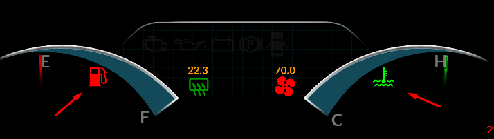

These fuel and temperature icons
These fuel and temperature icons are configured with different colors at each level, Normal Green, Attention Orange, Critical Red, in addition to these settings, it would be possible to make it stay off with the key off and only appear with the key on.
On some cases we use just a plain black gauge on top of the indicators which will hide when ignition is turned on. Another option is just to animate them away based on ignition.
