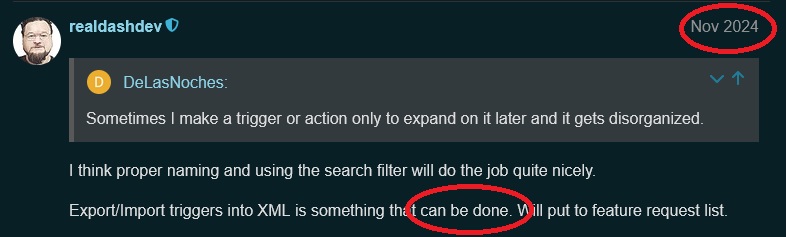

I think proper naming and using the search filter will do the job quite nicely.
Export/Import triggers into XML is something that can be done. Will put to feature request list.
