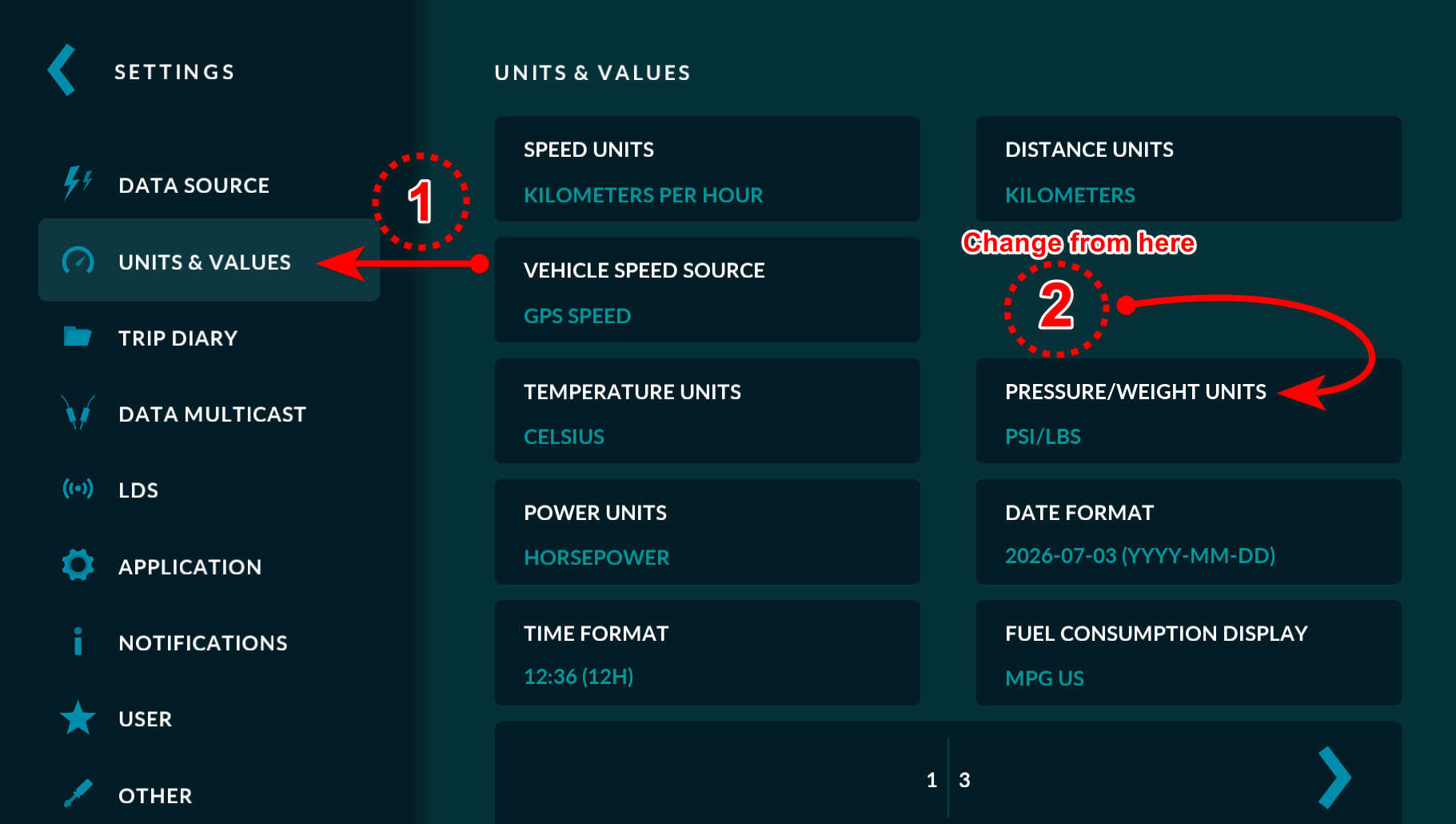

When I add a fuel pressure gauge and select the input, it only displays the values in PSI. I want to display the fuel pressure in BAR instead.
Does anyone know how to convert this inside RealDash or change the settings so the gauge shows BAR?
P.S.: Just a heads-up, my “Units & Values” settings in RealDash are already set to Metric.
