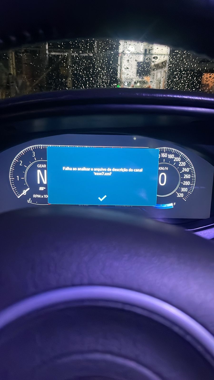

After the update I have a problem where I lose the XML all the time, and I have to go to the garage and rebuild it.
Thank you for reporting. This has been an issue on some previous versions. We have yet to been able to reproduce this issue. Will continue trying to get it happen on our test devices.
Is your Android device from forum user Falcon_S?

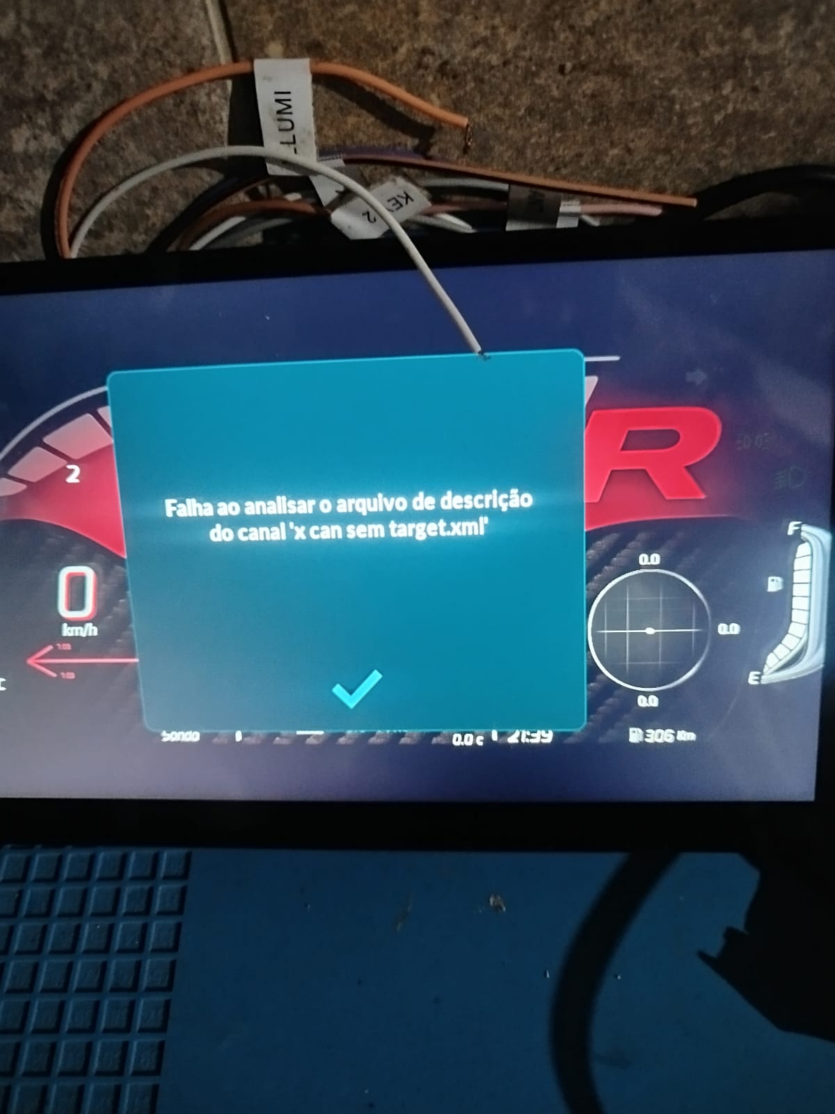

I’m also having the same problem after the update.
Good morning, after this new update this bug started crashing the XML file every time RealDash restarts. I already corrected the settings in the XML file to see if there were any errors, but the bug persists. I’ve seen about 5 people with the same problem after this new update.
This bug seems to affect only one hardware architecture with certain sleep mode-restart scenario which we have been unable to reproduce in testing. This is very probably a device firmware issue that launches app after sleep before the filesystem is fully ready for reading.
EDIT: Pushed the 2.5.9 into production. This version may help with XML loading issue on those specific devices.
Thank you, the problem has been completely resolved.
