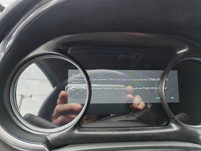

Hello, this is how it connection, after reboot
Android device developer mode is not needed.
