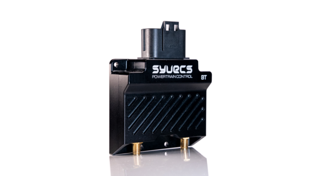

Thanks for that, I’ll give all that a go and come back to you, do you know if there is a CAN adapter that will send data over Bluetooth for an Android device to read while not taking the feed from the OBD? Or would it need to be something like this?
In the meantime is it going to be possible to get the oil temp and rear diff temp to work over obd2?
You do not need BTIMU Bluetooth module for CAN connection. Just one of the RealDash compatible CAN adapter.
Possible, yes. You need to make a custom OBD2 connection file. Its probably too complicated for me to do remotely for your vehicle.
Ok great thanks, I was think of going down the route of the SPLeinonen DashBox to output can information over Bluetooth. So I’ll get one of those at some point.
