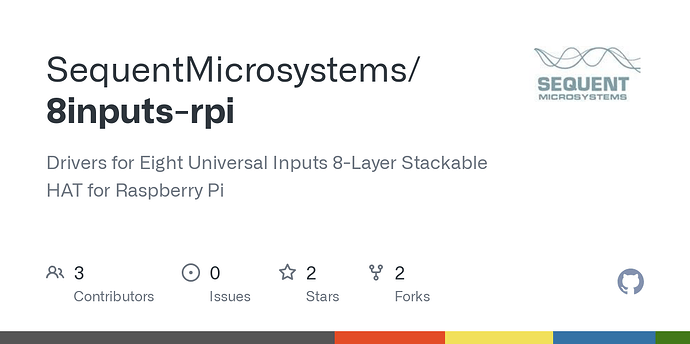

I have problem.

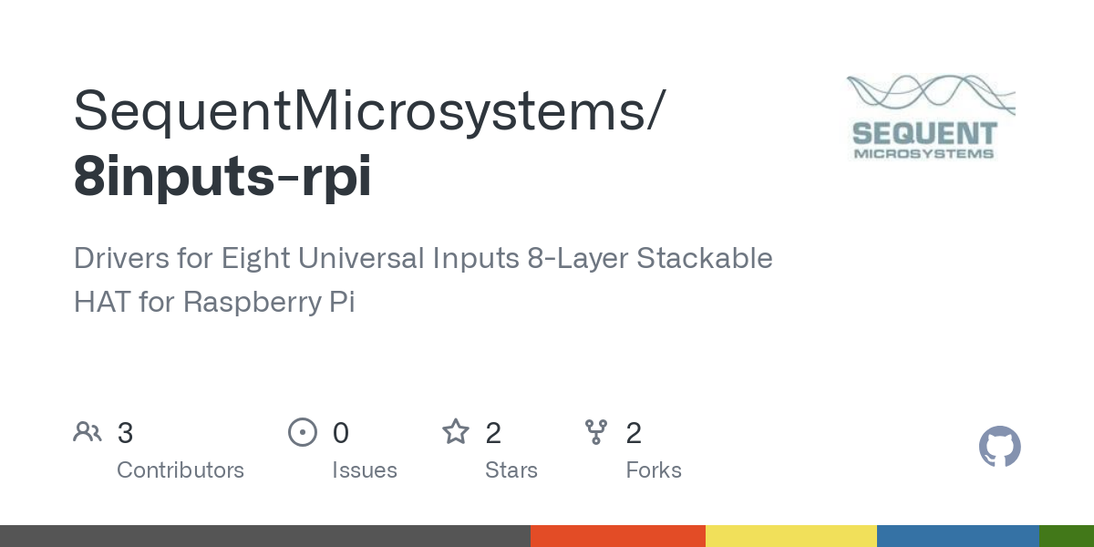

I have 8 input HAT on the raspberry pi 5 for 12v inputs for turnsignals etc. and i try to make them signal to gpio outs with node red and also tried to use python, the HAT uses I2C connection to raspberry. I got it worked one day but the signals was inverted. Did see that as big problem and go to sleep.
Next day i tried to continue my project then started real problems.
After many hours… and day.
This is whitout any coding on raspberry and its clean install OS.
Only realdash installed and HAT mounted.
  1. I open realdash and none of gpio are yet configured , then i open terminal to check the I2C connection by typing i2cdetect -y 1 , everything is OK.
  2. Then if i chose any gpio out or in and after that if i check the i2cdetect -y 1 , i just see ------- .
    Realdash gpio pick is somehow braking the I2C connection…
    Can someone help me .
HAT files:
Yes, if you use GPIO inputs or outputs RealDash reserves all of them. That is due how libgpio handles the inputs&outputs.
