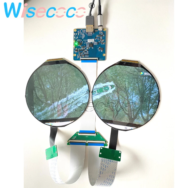

i literally just purchased https://www.aliexpress.com/item/1005003258271862.html?spm=a2g0o.9042311.0.0.38524c4dzo1fBZ , specifically the 2x lcd with driver board, it has an extended display mode meaning the two round displays combine to show the desktop
or is the issue more to do with aspect ratio? is 2:1 too wide?
it seems like the lions share of these 5" round displays are billed as 1080x1080 but are actually somewhat smaller as they’re a round stamp out of a square display
Cool looking display set! You’ll know when you test those. The problems with ultrawide displays are mainly on Android and seem to be dependent on driver board, not the display itself.
