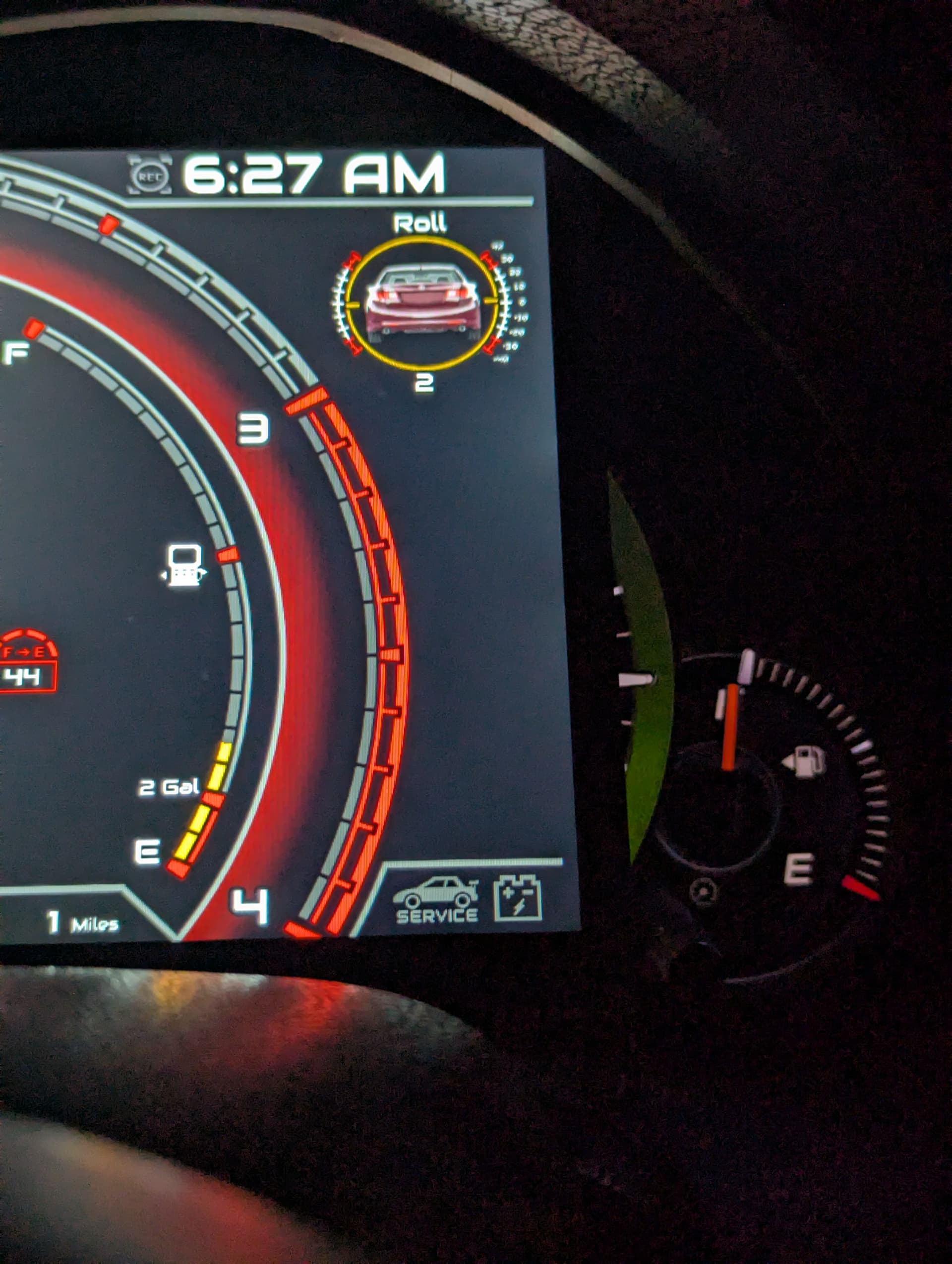

Here’s one of the issues. Fuel doesn’t reset to 0 up on disconnecting from OBD2. Nor does it fix itself when connected again. This issue has been persistent for a good while, noticed it while getting gas. If I close and reopen the app it’ll work correctly.
It is Body Electronics: Fuel Level, with OBD2 : Fuel Level Mapped to it.
OBD2: Fuel Level shows I have a full tank.
Something has to be wrong then with Body Electronics: Fuel Level.
Did a quick test and it was working for me, but I will run more comprehensive tests on OBD2 simulator.
You have to disconnect the OBD2 for a while, let’s say a minute.
When it disconnects all values reset except this one. And then when it reconnects it stays the same while the rest show accurately.
I have to exit the app and reopen for it to work correctly again. That or sometimes a good while after it fixes on its own.
Send me your custom OBD2 XML that has fuel level PID.
Not using one and never used a custom one. It’s been persistent as it also happened on my tablet setup before my current one.
