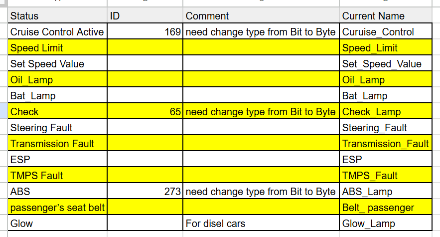

The gems are snowballing, fewer and more skins are being created, and I’m trying to unify them as much as possible. using specific variables is not a good option.
I want to take an example ID 65 ‘check’ - we have only BIT - for ‘Check’ flash/ i must greate pecific variables - Please made ID 65 Byte (all on off ID change to byte)
Why would ‘Check Engine light’ (ID65) need to have more than on/off value?
ID 65 some cars
0 - Off
1 - Show
2 - Blink 500 ms
ID 273 ABS Warning Renault Logan 2
0 - Off
1 - Show
2 - Blink 500 ms
3 - Fast Bbink 200 ms
If you just write an value to input 65, it does accept more than on/off, right?
Yes ID 65 not always, but on some projects it can have more values than 0 or 1
Oil Lamp - in a Mercedes, this is a warning light that is triggered by two events: low pressure or low oil level - Have specal ID
Battery Lamp - The charging system is malfunctioning, not a low level of charge

It’s easy to create a specific value, but there are two difficulties. 1 the other author of the skin does not understand this 2. specific values are not processed in global triggers. my list of additional IDs will close 100% of the current projects (I have made about 100 machines since I started using RD)
