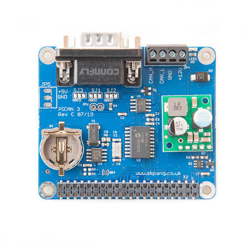

Passenger display is run by Raspberry Pi4, with PiCAN3 and Waveshare 11.9" ultrawide display:
PiCAN3 is very handy as it accepts 12V to power the entire stack, including the display. Passenger display connects to MaxxECU via CAN, and additionally to Dasaita TPMS module and shares the data to other screens via Multicasting.
Another cool feature on passenger display is that it controls the heater box. The original heater box was controlled by cables, which are now replaced with servo motors and RealDash controls those via GPIO to control fresh air vents, amount of heat and heat-defrost adjustment.
Raspberry Pi runs on 64bit Raspberry Pi OS (Debian based Linux).
I wrote a simple Python script to start/shutdown this screen automatically based on if Multicasting host is available. If not, HDMI display is deactivated and power save mode is activated on Raspberry Pi. That way is consumes very little power and boots in 1 second when needed.
