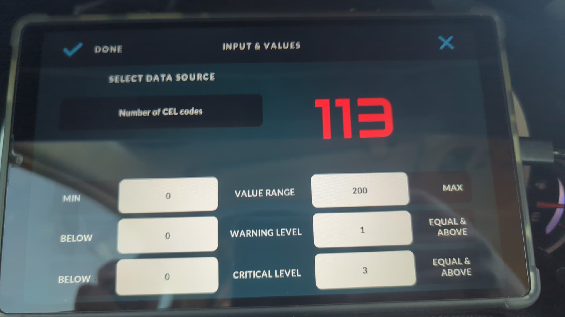

Also any updates on the number of cel codes?

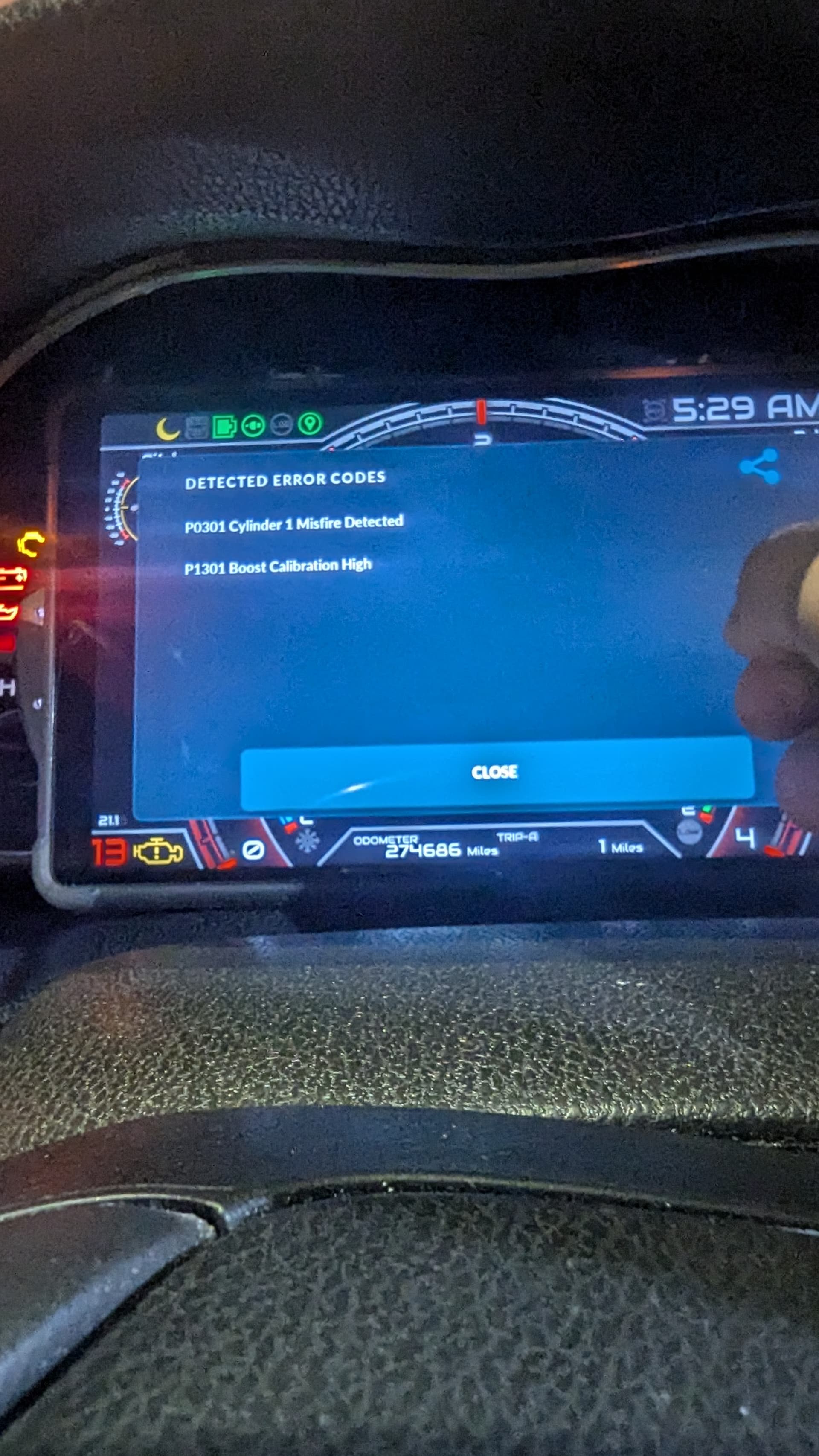

I used torque originally to check for what specific cell code I had. Stopped using them once RealDash was able to tell me cel codes. I decided to double check yesterday and the cel code Torque gives me is completely different then the cel code that RealDash gives me.
I get p0420 from torque and you guys give me p0104.

This is interesting, your vehicle responds to error code request with:
18DAF1110443010420
18DAF11D024300
As far as I’m aware of, This should result to error code ‘0104’, which is a P code P0104.
So are you 100% sure that P0420 is the actual ‘real’ DTC that your car has active? Can you confirm that on a proper scanner? Any vehicle that I know places the error codes right after ‘43’ indication that its a response to DTC request 03.
Could it be sending the character as well after the 43; so 43010420 is actuall 01 = P and then 0420 for the code;
Maybe 01 - P, 02 - C, 03 - B and 04 - U
So 43041000 would be U1000
Just a thought?

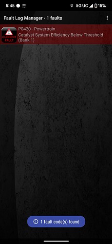

I can pass by an AutoZone or O’Reilly’s to double check but torque pro has usually been accurate with my car. I know I need a new catalytic as it’s been like that for a year. The other code is only 2 months new.
Also what was weird to me is that I’ve had another code that would show up with the p0420 code and those showed correctly on both apps.
This is the first time p0420 doesn’t show up on your app and gives me the other code instead.

Problem for me is that any other vehicle that we have tested lists error codes right after the ‘43’ reply code. In your case we would need to jump over the ‘01’ on the reply but there is no way to identify if 01 should be skipped or not.

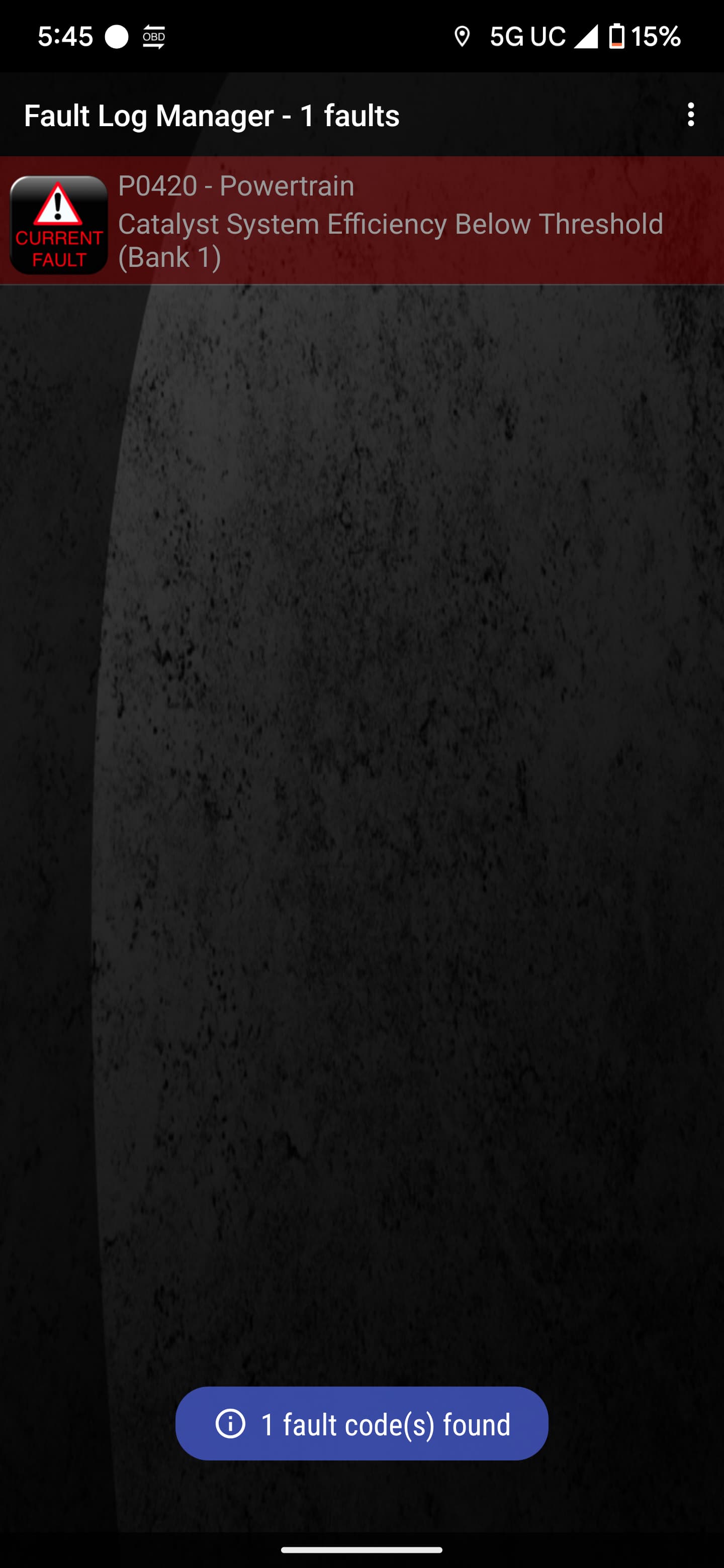

Let me unplug a sensor to see if I can trip another code and send you new data.

Just sent a new debit log to you.

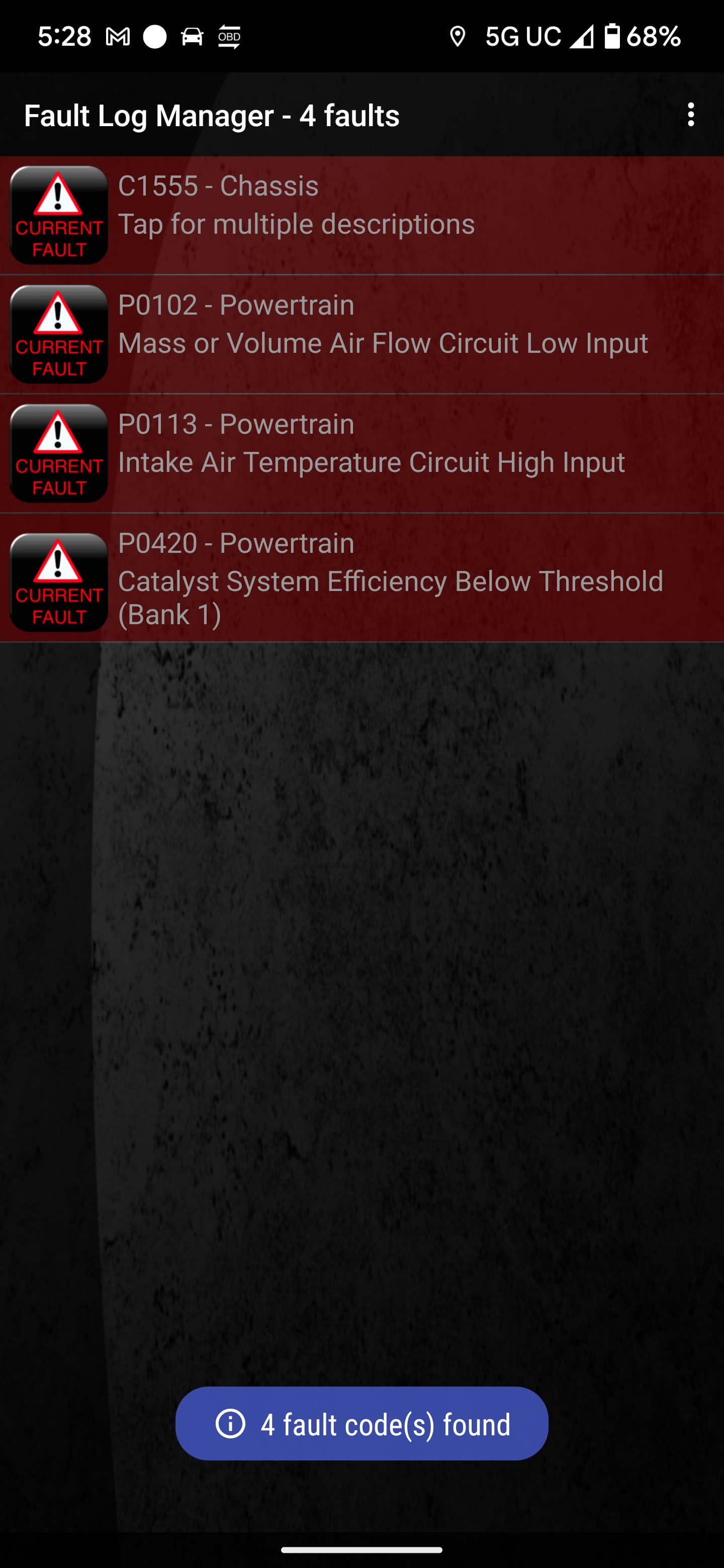

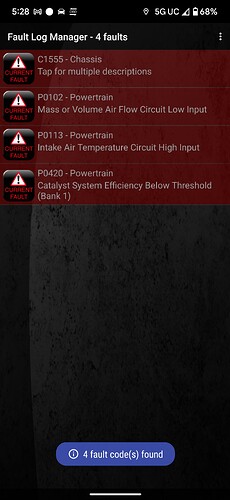

This is me with the original code but now unplugging the MAF sensor while engine was running.
I can take a look, but if issue is the same that there is an extra byte at the beginning of error codes, I’m not going to fix it as it would break error code reading for all other vehicles we have tested on.
Edit; I did some investigation. The C1555 error is not there, so that must be some kind of an erroneous read. Good news is that I did found a way to parse your error codes without breaking the support for other vehicles.
